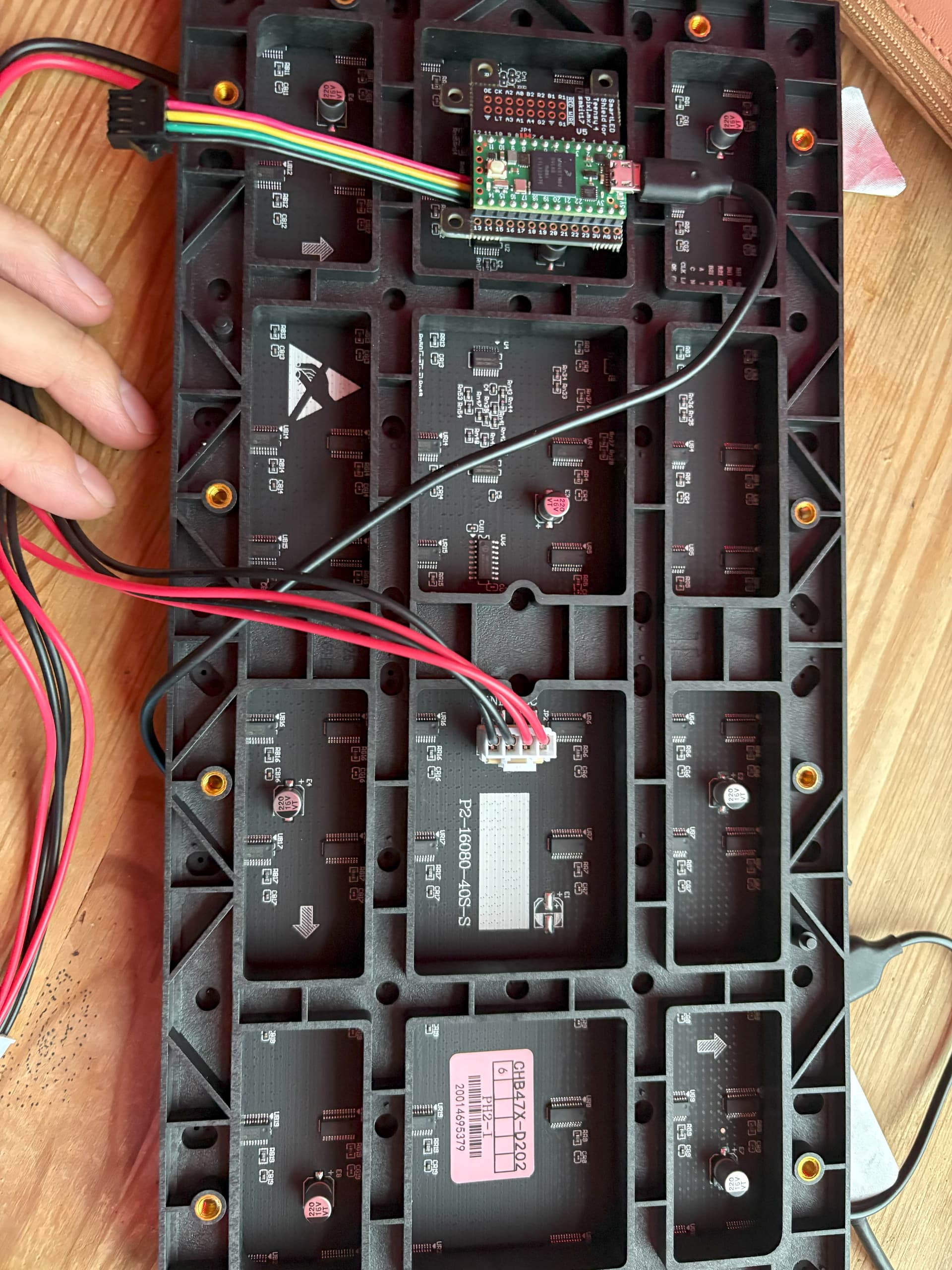

Hi all, new to this forum. Using a Teensy 4, I had a 64x64 from Adafruit that worked like a charm, now trying with a larger display I got from AliExpress. Its 160x80 2mm. I have tried all the kPanelTypes from 0-16 with no luck. Is there anything special that needs to be done with it? I actually have no clue what chipset it is, i dont really see any identifying info on the back.
Thanks for your help.

Sorry, SmartMatrix Library only supports panels that are a power of 2 in height, eg 16/32/64/128. Beyond that, I’m guessing these panels use a chipset that isn’t supported. These 160x80 and similar panels weren’t around when the library was made and I have no plans to add support.
I’m adding a note to the wiki to help others avoid these.
