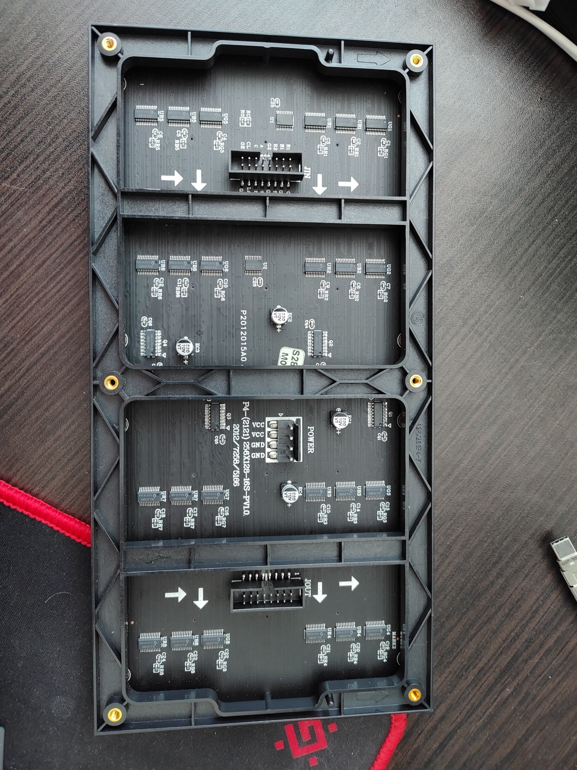

P4 64x32 16s PV1.0. with Huidu HD WF2
Hello! Has anyone had any experience with these panels? I’m trying to assemble a screen, and I’ve tried all the modes, but it’s not working. Something only appears in 1/32 mode.
The markings on the drivers are not clearly readable - something like “***2038S” ?
And what is the text on Q2 - Q4 chips?
All Chips is: TC7262k 60HBB1
Thanks.
But with this you wrote me aboat Q2-Q4 only.
Also, please specify the driver designations, for example for UR7, UG7, UB7… etc

As far as I can see, no. There are ICN2038S - standard drivers.
Frequency doesn’t matter. It is possible to lower the frequency if needed.
The driver model is what matters.
Good catch on the ICN2038S — those are bulletproof. But the fact that 1/32 mode works at all is actually promising, means the panel and controller are talking. If it was a dead driver or firmware mismatch you’d probably get nothing. Sounds more like a mode config problem than hardware failure. Have you tried flashing the Huidu firmware fresh, or checking if there’s a scan mode setting buried in whatever software came with it?
The panel on the picture has a label that stated it as 1/16s mode so I don’t see what the 1/32 can “promise” in that case.
